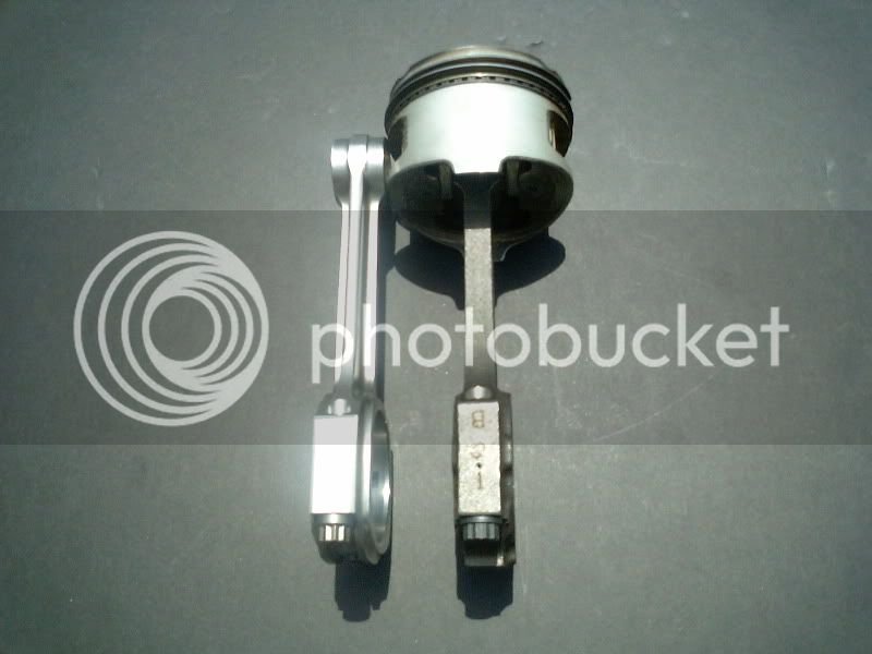

1uz vvti rod:
![rod_offset1.jpg rod_offset1.jpg](https://www.lextreme.com/forums/data/attachments/12/12996-bef2c515065b45f2bc26d1ecc077611d.jpg?hash=vvLFFQZbRf)

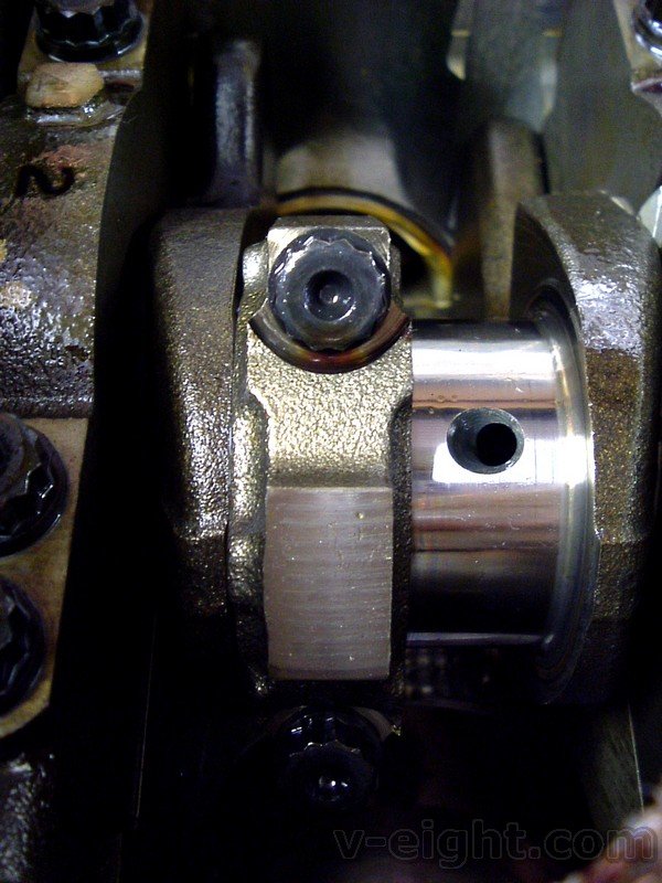

2uz rod (and pauter 2uz rod)
![IMGA1024.jpg IMGA1024.jpg](https://www.lextreme.com/forums/data/attachments/12/12997-d1080a8ee45728cbfae926bf39d452ba.jpg?hash=0QgKjuRXKM)

1uz vvti rod:
